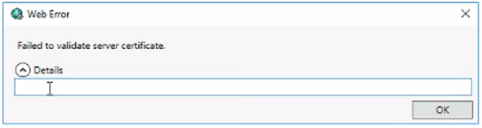

The following error is returned when adding a Site Server to the Internet Gateway (under the "Servers" tab):
Failed to validate server certificate
