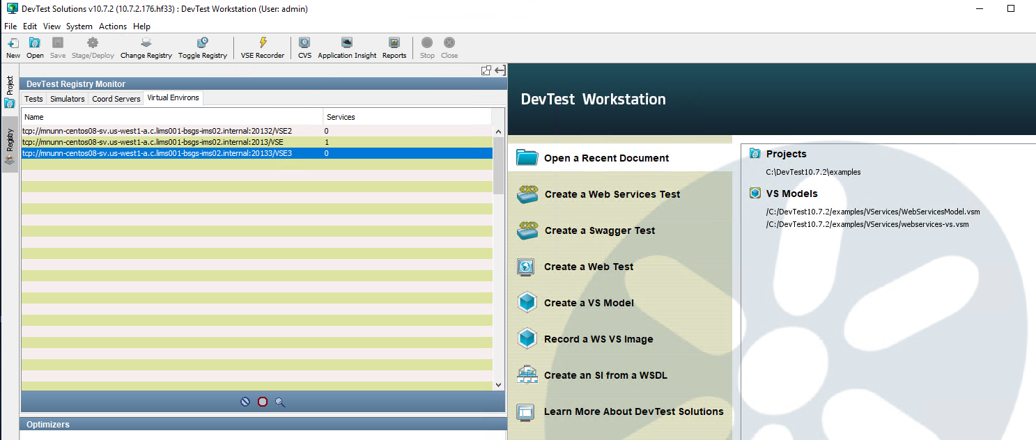

Verified additional VSEs can be access from Workstation:
https://techdocs.broadcom.com/us/en/ca-enterprise-software/devops/devtest-solutions/10-7/using/using-service-virtualization/sv-installation-and-configuration/how-to-run-multiple-vse-services-on-a-single-server.html
