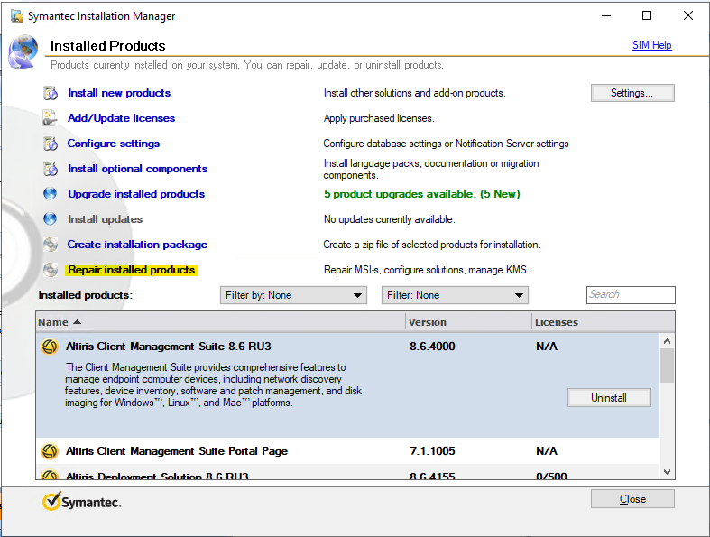

Typically, you can resolve this issue by going into Symantec Installation Manager (SIM) and running a full repair & reconfigure.  You do this by going to Repair installed products in SIM and then selecting Perform full repair and/or Reconfigure installed products as seen here:
