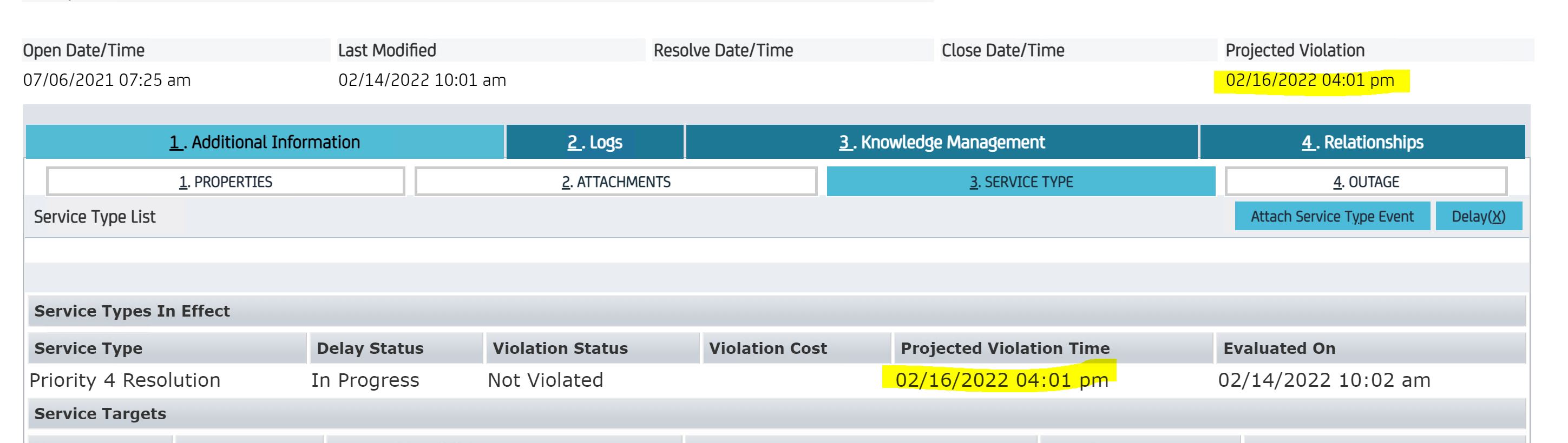

How to display the field "Projected Violation Time" which is under Service Type tab, directly into the detail_in.htmpl form.
Release : 17.3
Component : SDM - Customizations
In the detail_in.htmpl form use below syntax where you need to display the field:
<PDM_MACRO name=dtlDateReadonly hdr="Projected Violation" attr=attached_slas.time_to_violation>
It will be displayed as below:
