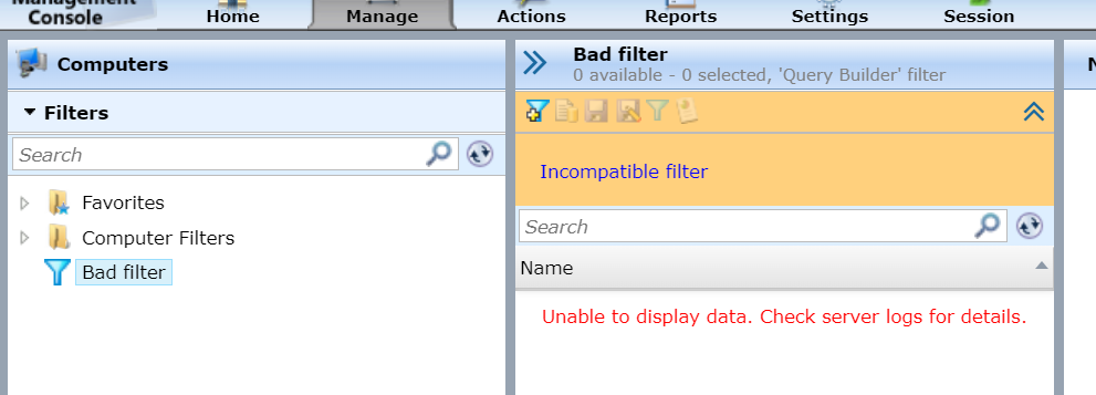

When you try to open the filter in the HTML5 view it shows the following error message:
An error has occurred while loading the filter. Check server logs for details

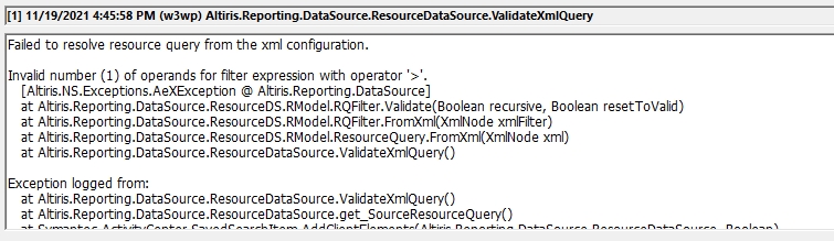

In the server logs, the following was seen:
Failed to resolve resource query from the xml configuration.
Invalid number (1) of operands for filter expression with operator '>'.
MainController failure.
Column '[].[]' is not found
   [System.ApplicationException @ Symantec.ActivityCenter.Api]
   at Symantec.ActivityCenter.Api.Models.Filter.SavedSearchToFilter.FindColumn(String dataTableName, String columnName, SavedSearch savedSearch)
   at Symantec.ActivityCenter.Api.Models.Filter.SavedSearchToFilter.GetFilterCriteria()
   at Symantec.ActivityCenter.Api.Models.Filter.SavedSearchToFilter.Convert()
   at Symantec.ActivityCenter.Api.Models.Filter.FilterProvider.GetFilter(Guid id)
   at Symantec.ActivityCenter.Api.Controllers.MainController.GetFilter(Guid id)
   at lambda_method(Closure , Object , Object[] )

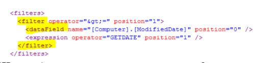

The issue is related to the structure of the item xml, which is created if we build a filter using the legacy UI. By ECV design, the dataField node is expected under the expression node (see for more details  SavedSearchFilter class and SavedSearchFilterExpression class)
Example:
When we build a filter using the legacy UI, the dataField node can be under the filter node. This case is not supported by the ECV.
Example:

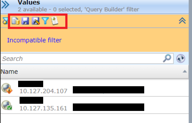

This issue has been fixed under ITMS 8.6 RU3 release. With ITMS 8.6 RU3, we throw "IncompatibleFilterException" in the ECV codebase whenever the backend code is unable to parse adequately the filter XML.  In that case, ECV filter UI looks like this:
The "incompatible filter" link points to the SMP Core UI where the filter can be properly edited:
