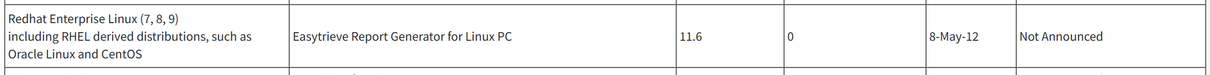

Please see this link for the following information regarding Redhat Enterprise Linux releases which are supported:
https://support.broadcom.com/web/ecx/support-content-notification/-/external/content/release-announcements/CA-Easytrieve-and-CA-Pan-SQL-Release-and-Support-Lifecycle-Dates/4359
So,  Redhat Linux 6, 7, and 8 are fine with Easytrieve release 11.6, the latest release.
6, 7, 8 are major versions of Redhat Enterprise Linux distribution. The distribution is a collection of "Linux" kernel and 3rd party libraries and utilities, which allow one to run the system.  Linux versions 6, 7, 8 (including the minor releases such as 7.7) are supported by Easytrieve for Linux.
The "linux" itself is just the system kernel (aka z/OS nucleus), which has its own version, that is not related to the distribution version.
Easytrieve doesn't have dependency on specific linux kernel version, nor linux distribution, it just needs 32-bit support and glibc >= 2.12.  GlibC is a C runtime library and provides 32-bit support.
Easytrieve officially supports RHEL distribution family, but it works on virtually every Linux distribution.
