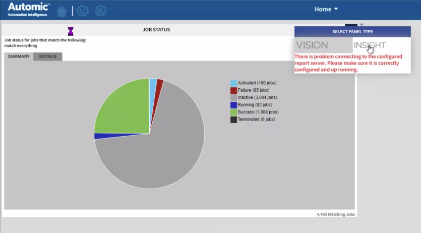

AAI Insight not showing the full list of Insight reports in Chrome
When accessing the Insight tab after a successful Insight installation and configuration we see the error "There is problem connecting to the configured report server. Please make sure it is correctly configured and up running."
