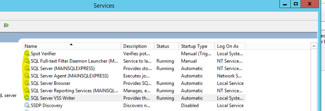

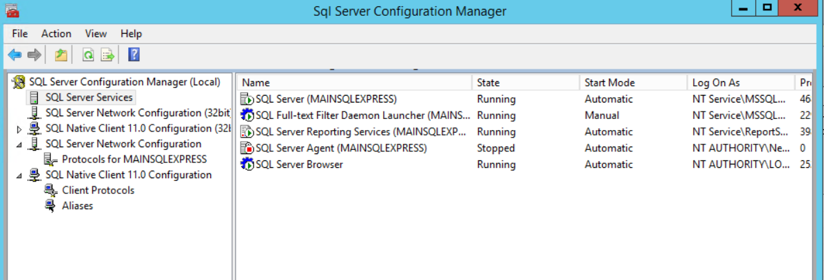

SQL Server services were stopped.

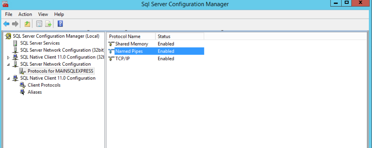

Named Pipes in SQL Server Network Configuration was disabled
Connect to the Database server and make sure all SQL Services are running.  (If SQL Server agent is not running, try to run it as well. although it could be failed)
Restart the services and check the NS again.
If the issue is not resolved, open the Sql Server Configuration Manager> Sql Server Network Configuration> Protocols for the CMDB, and make sure all options are enabled.
