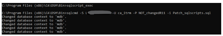

7. Now execute sqlscript_exec from DSM\Bin location. ( Make sure you have correct password for ca_itrm is set in this file).
Execution will end like below.
