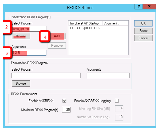

How can Automation Point administrators setup the product so that REXX program(s) run at startup?
  1. Open Configuration Manager -> Expert Interface -> Automation -> REXX -> REXX Settings
  2. Click on 'Browse to search for a REXX program
  3. Specify the program arguments to supply this REXX program
  4. Click the 'Add' button
  5. Repeat steps 2-4 for every REXX program you want to Invoke at AP Startup
