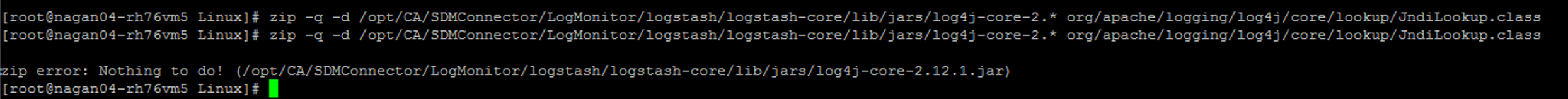

$ zip -q -d /opt/CA/SDMConnector/LogMonitor/logstash/logstash-core/lib/jars/log4j-core-2.* org/apache/logging/log4j/core/lookup/JndiLookup.class
Where /opt/CA/SDMConnector/LogMonitor/logstash/logstash-core/lib/jars/log4j-core-2.* are the files where the zip will remove the JndiLookup.class (org/apache/logging/log4j/core/lookup/JndiLookup.class)
You can also run these commands:
$ cd /opt/CA/SDMConnector/LogMonitor/logstash/logstash-core/lib/jars/
$ zip -q -d log4j-core-2.*org/apache/logging/log4j/core/lookup/JndiLookup.class
If you get the following message, that means that someone already removed the JndiLookup.class from the log4j-core-2.12.1.jar file:
zip error: Nothing to do! (/opt/CA/SDMConnector/LogMonitor/logstash/logstash-core/lib/jars/log4j-core-2.12.1.jar)
