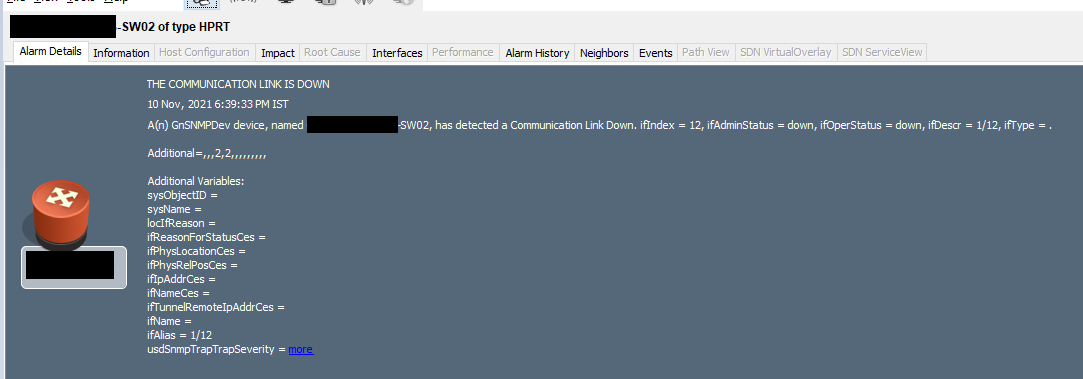

The following alarm is generated on the device model for an interface model that is placed into Maintenance Mode.
The alarm is a Link Down trap for an interface model that is in Maintenance Mode. Placing an interface model into Maintenance Mode only prevents the alarms on the interface model not the device model.
