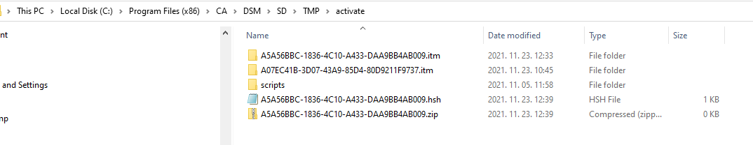

On NOS-Less SD Agent if there was an unexpected problem during the NOSLess download of a SD Package, some files could remain in folder C:\Program Files (x86)\CA\DSM\SD\TMP\activate on the SD Agent.
Example :
On this agent, there are 2 directories .itm, 1 file .hsh and 1 file .zip in directory SD\TMP\activate
How to clean this directory on the Agents ?

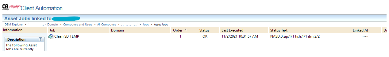

- This script generates a log C:\Program Files (x86)\CA\DSM\logs\clean_sd_tmp.log
Once executed the status of job displays a comment like :
NASD:0|1 zip:x/y hsh:x/y itm:x/y
or
SD TEMP is clean
NASD:0|1 indicates if Agent is a collaborating Agent for "Neighbor Aware Software Distribution". 0=Not collaborating Agent.  -  1=collaborating Agent
zip:x/y indicates that x .zip files have been deleted and y .zip files have been found
hsh:x/y indicates that x .hsh files have been deleted and y .hsh files have been found
itm:x/y indicates that x .itm directories have been deleted and y .itm directories have been found
In above example the status Text is :
NASD:0 zip:1/1 hsh:1/1 itm:2/2
NASD=0 means that Agent is not a collaborating Agent for "Neighbor Aware Software Distribution"
zip: 1/1 means that 1 zip has been found and 1 zip file has been deleted
hsh: 1/1 means that 1 hsh file has been found and 1 hsh file has been deleted
itm: 2/2 means that 2 directories .itm have been found and 2 directories .itm have been deleted
