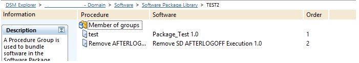

If sending a package with option "Prevent user from being logged-on while job executes (WinNT only)" is needed, package "Remove SD AFTERLOGOFF Execution" should be executed again after.
This could be done automatically with a Procedure Group which contains in this order :
- The package procedure with option "Prevent user from being logged-on while job executes (WinNT only)"
- The procedure "Remove AFTERLOGOFF sdagent" of package "Remove SD AFTERLOGOFF Execution"
And send the procedure to the computers.
