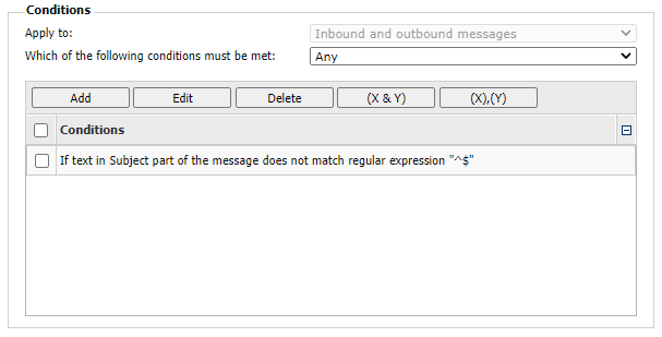

Workaround
Messages with an empty Subject header can be exempted from URL modification processing by adding a clause to the URL modification content filtering policy similar to the entry below:
As with all changes to Content Filtering policies, any change should be carefully tested using a limited set of test users before applying the change to larger groups of end users.
