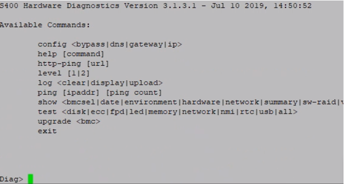

    c)when you see count down press space bar and then "d" and select newest hardware diagnostic image 3.1.3.1
2. System will start install drivers it may take from 3-5min
3. After Hardware Diagnostic load, put upgrade bmc
4. Follow the instruction after BMC upgrade
