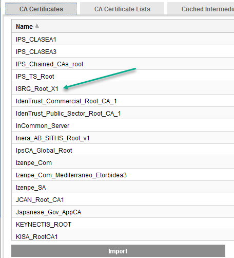

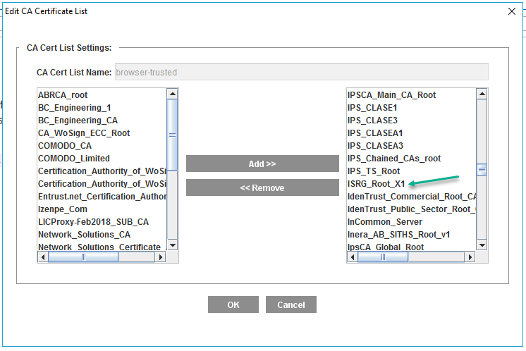

The root certificate ISRG Root X1 has also been linked to Let's Encrypt expiration issues as found in 'Chain of Trust' Hierarchy above.  Being imported into CA Certificates, then into added to Browser Trusted for affected domains has proven to resolve this issue.  If you find additional Let's Encrypt certificates affected, review the Chain of Trust Hierarchy to see if there is a certificate related that needs to be imported for the expired.
Note the Examples below for ISRG Root X1:
