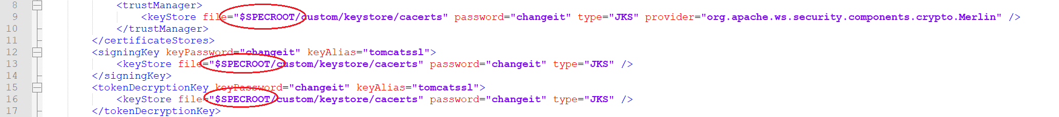

The installer was trying to preserve settings from the just backed up fediz_config.xml file and ran into a parse error due to an improperly formatted word.
The fediz_config.xml file contained <SPECROOT> inside of xml tags.
example line that caused the parse errors
Manually modified the backed up fediz_config.xml changing the <SPECROOT> reference to $SPECROOT
$SPECROOT/Install-Tools/LOGS/21.2.x.x.xx_xxxxxxxx/tomcatBackup/fediz_config.xml
Reran the 21.2.x installer which completed successfully and Spectrum is fully functional.

     Check existing fediz_config.xml files for <SPECROOT> and if found, change to $SPECROOT prior to running the upgrade. If not found then
        the problem should not occur.
On Linux systems using find/exec/grep  from bash (replace install dir /usr/Spectrum as necessary)
    find /usr/Spectrum/ -name fediz_config.xml -exec grep keyStore {} \;
