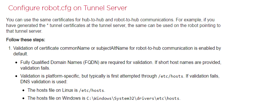

The certificate used for the tunnel server (and thus for the robots assuming you are using the same certificate) should be issued to the actual FQDN of the local server.
From the techdocs:
Alternatively you can also can use wildcard certificates  but they must be issued to a generic/true wildcard  (*)  as opposed to a domain-qualified wildcard (*.example.domain.com)
In the case of a third party/CA Signed certificate, the server may have an external name e.g. (hostname.example.domain.com) and an internal name (hostname.example.network.local) and the certificate will have been issued to the external FQDN.  The robot would be checking the internal FQDN. So in this case you should obtain a new certificate where the SubjectName is the external FQDN, and the SubjectAlternateName is the internal FQDN.  This will allow the same certificate to be used for the tunnel server and the robots.
