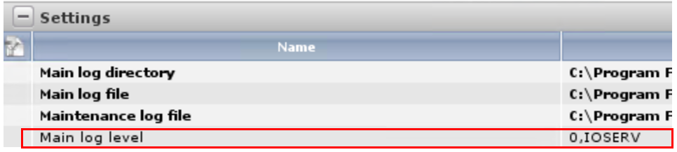

Below mentioned configurations are suggested to troubleshoot communication/data loss issue between DU and DUX.
  • In node settings set logging - main log level: 0,IOSERV and save the updated setting. This configuration will write additional trace lines in universe.log
Administration -> Nodes -> Selected Node -> Node Settings -> Logging
