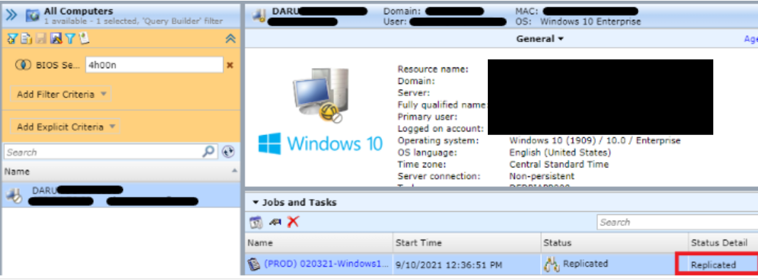

Trying to re-image some machines so new users can use them. These are pre-existing computers.
Some of those machines will fail when the image job runs on them. When those jobs fail, the only status that they get is "Replicated" as seen here:
Hierarchy was never set up so the "Replicated" status doesn't make sense. Also, they are not using a "standalone replication" rules to send these computers information between two SMP servers.
If they delete these computers from the SMP Console, then the image job works or if it fails, at least they see a "Failed" status rather than the "Replicated" status.

The problem is related to resources that are selected as targets for deployment. The specified computer is detected as "unknown" resource by the Task Server and since task itself is replicable - it gets "replicated" status.
Two possible scenarios:
  1. Somehow the Task Server failed to recognize them and assumes that they are managed by some other SMP Server.
  2. The affected resources may have an asset status other than "Active"
Make sure these pre-existing machines are not set to an Asset status other than "Active".
Note: In this particular scenario, this is what we were able to discover. According to the process being used, when they get the client machine from an User, they change the asset status from "Active" to "In Stock". Then, when it is time to return the machine and done with imaging, then they change it back to "Active".
ITMS is supposed to be looking for machines with an active status.

The machine that was being tested with was in the results so this other query was run:
select * from vComputerResource where Guid = 'GUIDgoesHere'
and the test machine was not there. This confirms that the Task Server can't see it as an active machine that can assign the image task to run.
