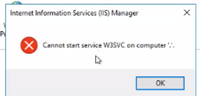

Package servers are only publishing software releases in UNC. When checking IIS Manager, it showed the error:
IIS service was stopped and failed to start:

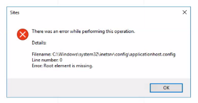

ApplicationHost.Config in 'Windows\system32\inetsrv\config\applicationHost.config' was corrupted (Size was 0KB)
