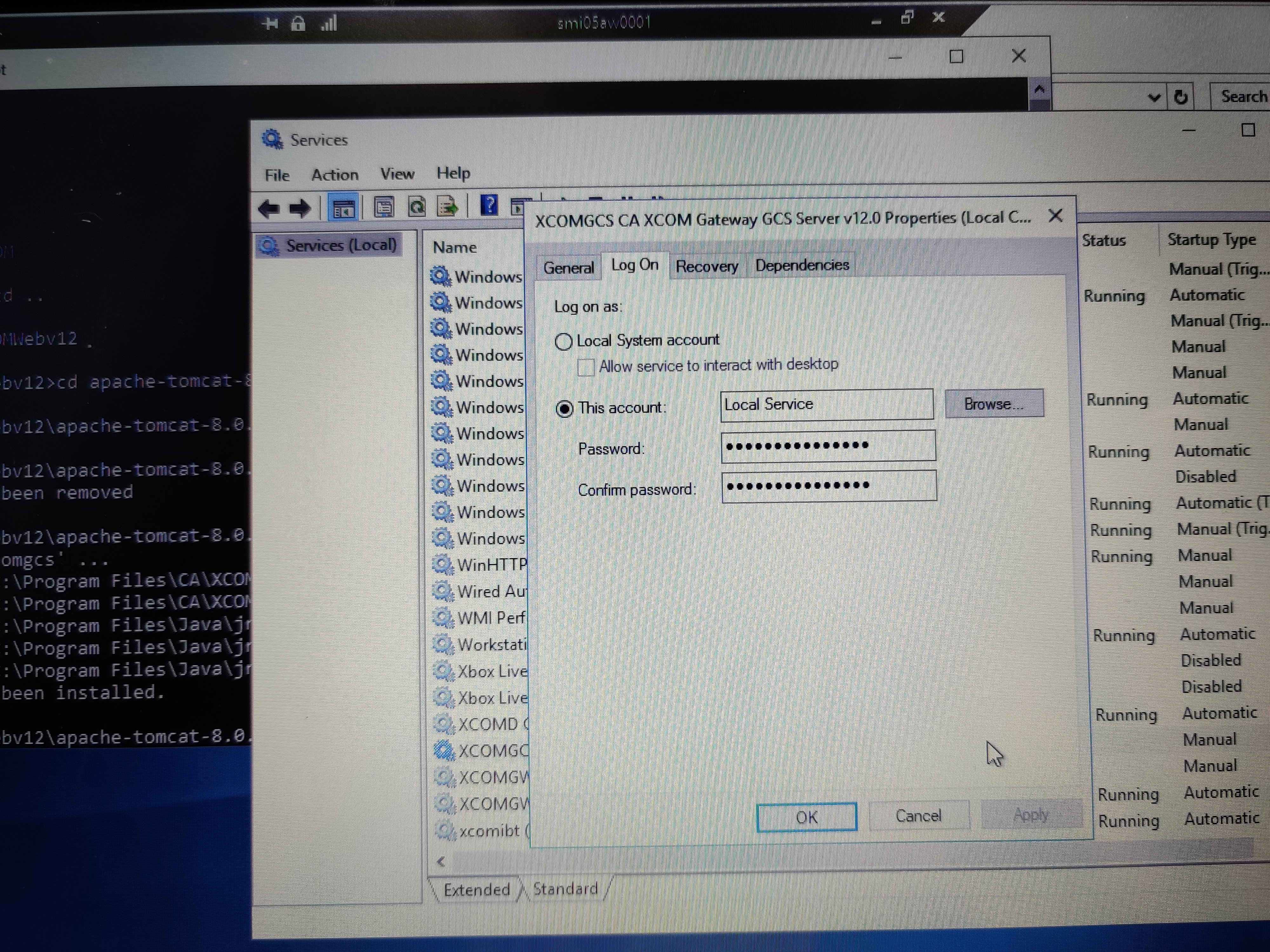

The cause of this error was that the xcomgcs service was logging on as a non system account.
See figure 1 below in the additional information section.

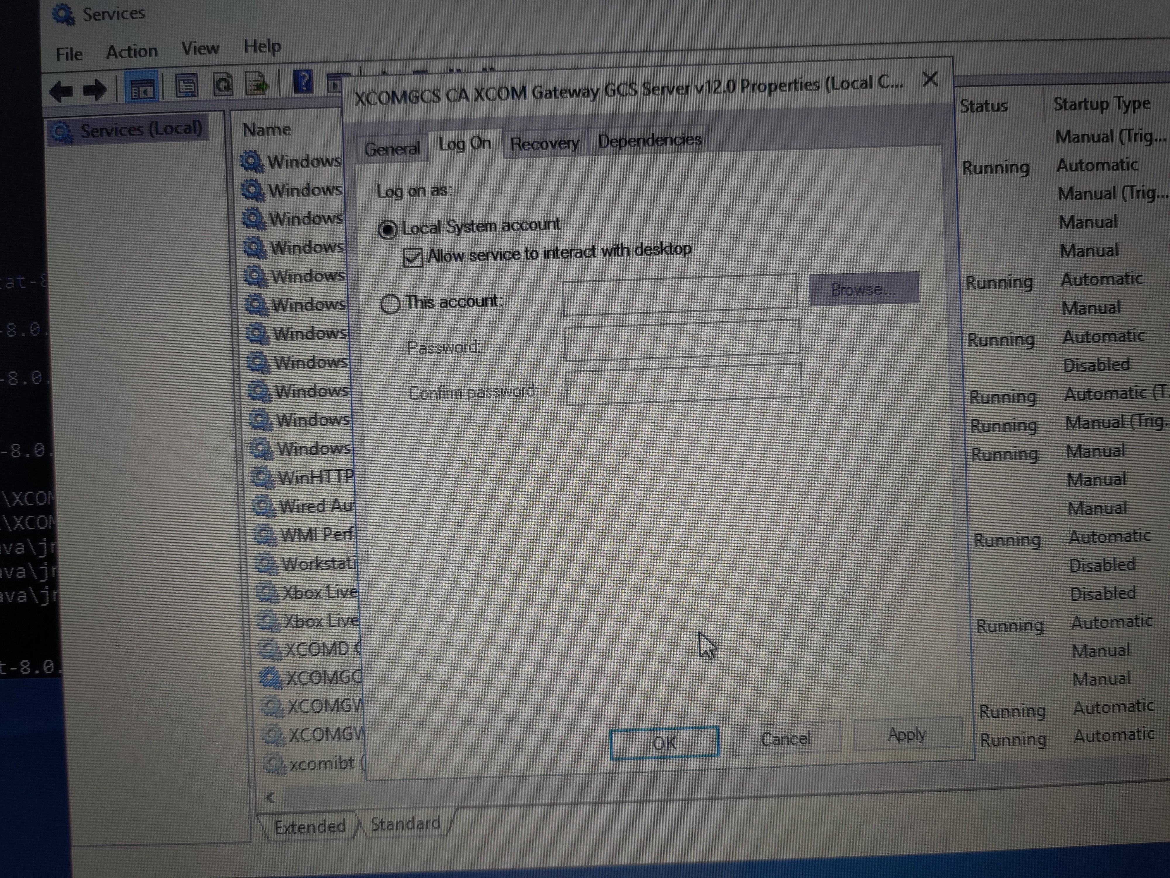

The issue was resolved once the xcomgcs service was able to log on as a Local System account with Allow service to interact with desktop enabled.
See figure 2 below in the additional information section.
Figure1
Figure 2
