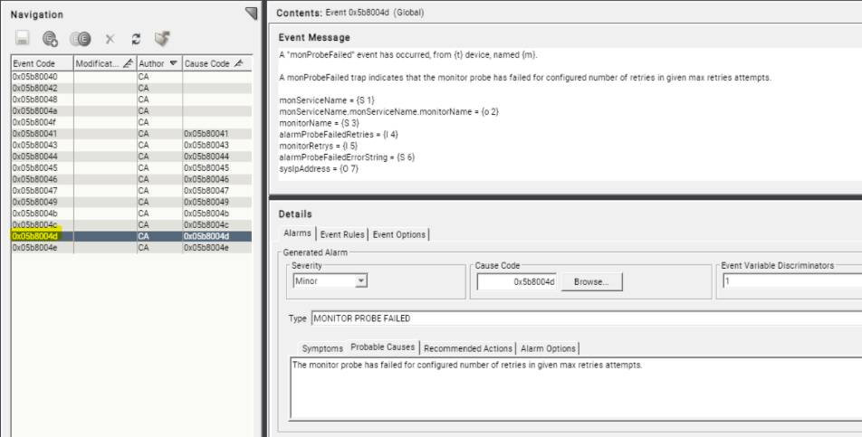

So the steps are:
1. Obtain an updated NS-ROOT-MIB from the device vendor.
2. Compile and import the new Mib Using Mib Tools and replace the existing one.
3. In the MIB trap support you will see the new trap already mapped to new event.
and from Event Configuration
NS-ROOT-MIB
