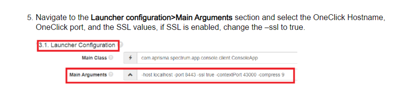

In versions previous to 21.2 (10.4.3 and lower) and configuring tomcat and webtomcat for SSL connection, there was a requirement to add Main Arguments to call back to tomcat on SSL port within the https://<OC_address>:<port>/spectrum webtomcat admin page:
However this is no longer required on 21.2, as webtomcat will read Main Arguments parameters from webswing.config file.
As such, if SSL was configured on a version previous to 21.2, then the parameter "${customArgs}" may have been removed, if following the documentation as noted by the screenshot above.

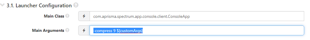

To solve this, configure webtomcat Main Arguments parameters to only show the following:
-compress 9 ${customArgs}

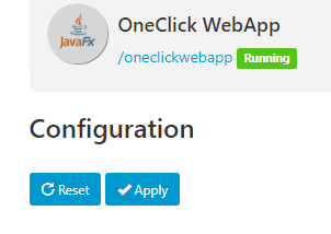

3. Click "Manage"
4. Select OneClick WebApp config, and scroll to 'Main Arguments" parameters, and verify the parameters are correct as noted in the below screenshot:
5. Be sure to select "Apply" to save the changes
