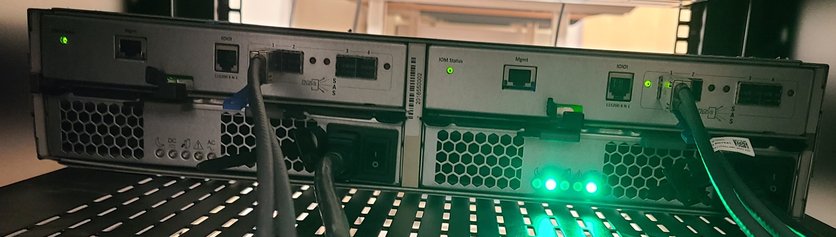

Physically check the hardware in the data center. There should be two green lights to the left of the power switch for each of the power supplies. If they are not on, there is a problem. In this case, the power supply to the left is turned off and the two green lights are off.

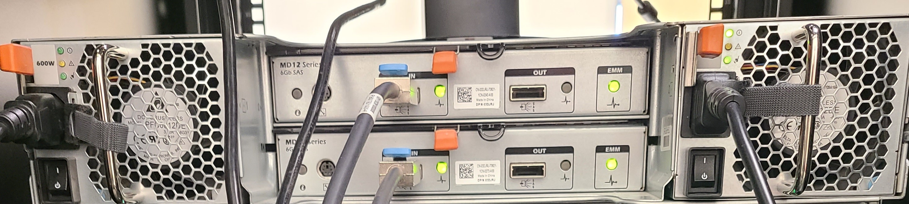

For the Dell MD1400 drive enclosures, the lights are in the top left or top right corners, above the power cords. The top left in this case has no power while the top right lights show there is full power. The power cord on the left is not in tight. If the bottom light is on, the power cord is plugged in but the power switch is off. The power status would need to be checked from the iDRAC.
Check the power cords and push them in hard. Check that the power switches are all on.
