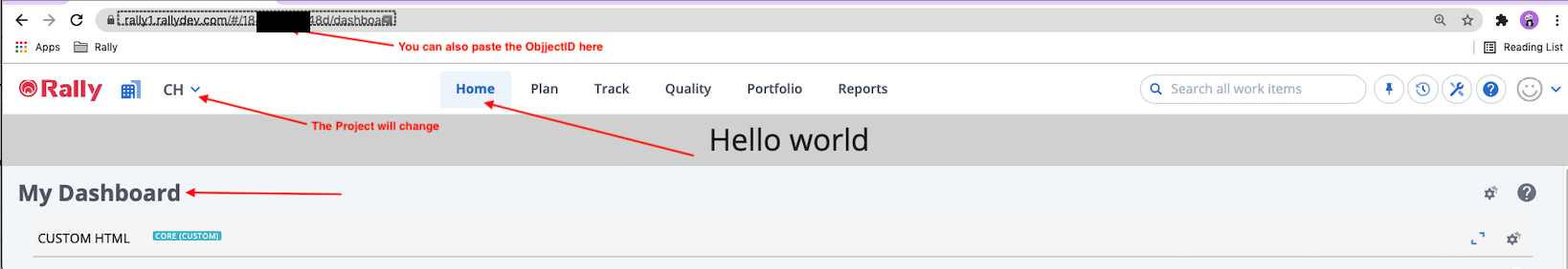

Option 1 to find Project.
  • Through the Home>Dashboard page by replacing the current Project ObjectID in the URL at the top of the page with the Project ObjectID in the error message.
    • If you receive a 404 Not Found error, please confirm you are in the correct Workspace.
    • If you are in the correct Workspace the project may be closed and you will need to use Option 2 below to find the project.
