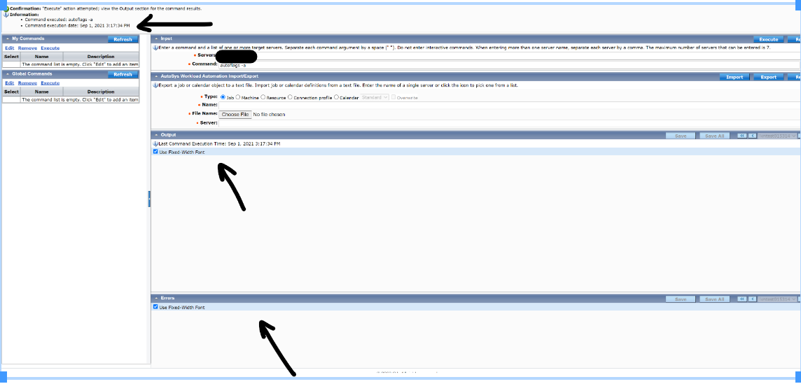

WebUI is not displaying output from ECLI commands.  No error / output in the panes. The command itself seems to run fine.

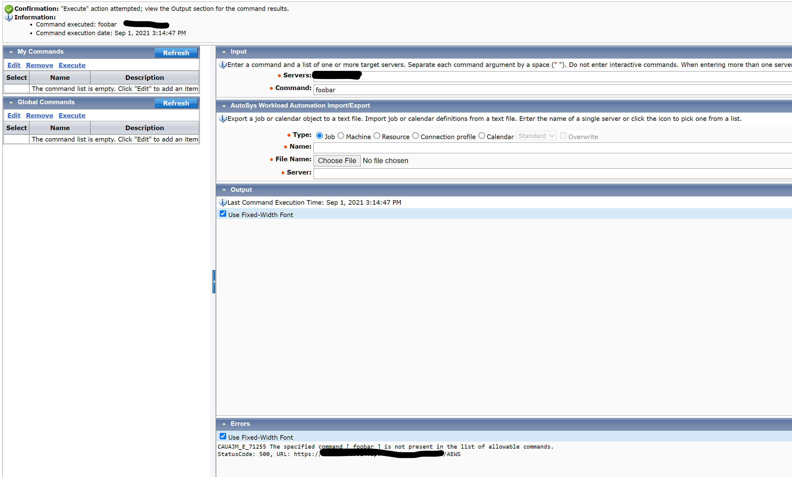

Normal execution of a command via ECLI would show output like this
  1. Confirmation: "Execute" action attempted; view the Output section for the command results.
If a command that is not supported is attempted, you get an error like below
CAUAJM_E_71255 The specified command [ user123 ] is not present in the list of allowable commands.
StatusCode: 500, URL: https://FQDN.Company.com:9443/AEWS
But this customer situation was resulting in no text at all to the Errors nor Output panes. Its just null.    Command appears to run fine though.
No text shows up in the output / error panes
WCC's commandapp.log shows something like this:
commandapp.log:
 <commandRequest><command>autorep -h -saml &quot;UserSession;Version-1.0;80e1ef18b587045b464831d647d2bf8-60f81f47-a40f0870-121f3&quot;</command><osUser>ejmcommander</osUser><osPassword>masked_encrypted_password</osPassword><timeout>300000</timeout></commandRequest>
2021-09-01 13:50:52,403 @ecli <      Thread-48> []  INFO #WebServerCommandClientReq          # Status: 200
2021-09-01 13:50:52,403 @ecli <      Thread-48> []  INFO #WebServerCommandClientReq          # Response: {}
2021-09-01 13:50:58,808 @ecli <      Thread-49> []  INFO #CommandProcess                     # Executing request for AutoSys
2021-09-01 13:50:58,808 @ecli <      Thread-49> []  INFO #CommandProcess                     # command: autorep -h
2021-09-01 13:50:58,808 @ecli <      Thread-49> []  INFO #WebServerCommandClientReq          # URL: https://hostname.company.com:9443/AEWS
2021-09-01 13:50:58,808 @ecli <      Thread-49> []  INFO #WebServerCommandClientReq          # Body:
 <commandRequest><command>autorep -h -saml &quot;UserSession;Version-1.0;122199e72374b468dca62d8b68202bc5-60f81f47-a40f0870-121f7&quot;</command><osUser>ejmcommander</osUser><osPassword>masked_encrypted_password</osPassword><timeout>300000</timeout></commandRequest>
2021-09-01 13:50:58,925 @ecli <      Thread-49> []  INFO #WebServerCommandClientReq          # Status: 200
2021-09-01 13:50:58,925 @ecli <      Thread-49> []  INFO #WebServerCommandClientReq          # Response: {}
1.2.3.4 - ejmadmin [01/Sep/2021:13:50:52 -0400] "POST /AEWS/command HTTP/1.1" 200 12
1.2.3.4 - ejmadmin [01/Sep/2021:13:50:58 -0400] "POST /AEWS/command HTTP/1.1" 200 12
Notice that the HTTP code is 200 Success,  which means that the operation finished fine.  However, the Response was just 12 bytes, which was pretty much an empty from WCC perspective.
