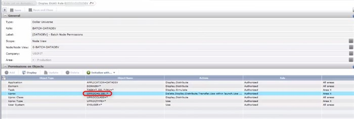

Uproc naming convention not bing respected as the Role that End Users with the problem had attached to its Group only authorizes to create uprocs named U_DD_* as seen below:
In the error message, we could see that the uproc name was U_BBGBO_LIQUIDITY_SOURCES_FUTURES_FUTOPT but the Role would only authorize Uprocs named U_DD_*
Normal behavior: the current Role definition should not allow users to create uprocs with a name other than U_DD_* .
Solution: rename the uprocs to respect the convention U_DD_* or modify the Role definition replacing the U_DD_* by U_BB* or similar
