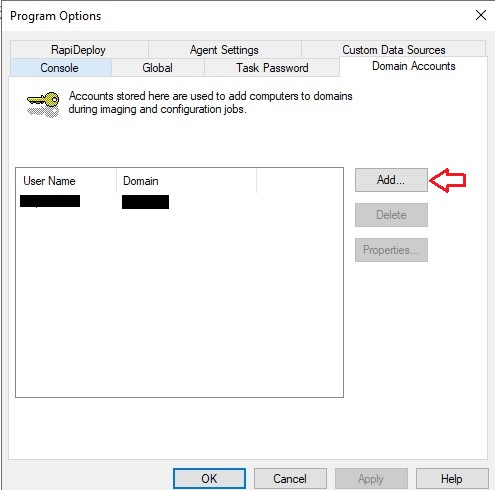

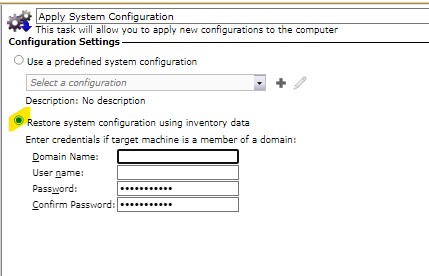

Bad credentials were set for the Domain Account for Active Directory
In the GSS Console go to Tools > options | Domain Account and add or modify the account and set the proper credentials for the Active Directory as shown here:
In the SMP Console, for DS, add the Domain AD credentials to the 'Apply System Configuration' task as shown here:
