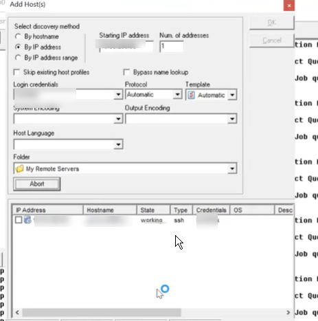

Need to enable agent less monitoring on Centos 8 server but rsp probe is not able to discover the server
Note: This KB example is for Centos 7 , but similar could be applicable to other UNIX/linux disributions
Release : 9.2.0/20.x.x/@0.4.x
Component : UIM - RSP 5.50
sudo user admin created to use in rsp probe
Can see below errors in log
Jul  1 11:19:49:021 [8908] rsp: run_command_Others: - Command Timeout
Jul  1 11:19:49:021 [8908] rsp: run_command_Others: Received an error - 3. Raising Alarm
Jul  1 11:19:49:021 [8908] rsp: run_data_gathering: Failed to execute command /bin/uname -s -v -r -m
Jul  1 11:19:49:021 [8908] rsp: get_ostype: failed to find OS
Jul  1 11:19:49:021 [8908] rsp: thrDiscoverHost: xxxxx.xxx.xyz.com - connection timed out
Jul  1 11:19:49:021 [8908] rsp:  Time taken in xxxxx.xxx.xyz.com=405
Jul  1 11:19:49:021 [8908] rsp: SREPLY: status = 0(OK) ->xx.xx.xx.xx:56064

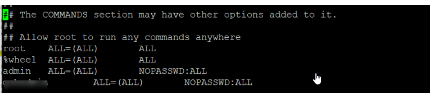

Manual logging with same admin user on Centos server and the command works ok
Below changes done on /etc/sudoers file
  1.  Add the sudo user say admin  in wheel group if not already done
          usermod -aG wheel <username>
          usermod -aG wheel admin
          2.Move the % wheel line above the users as in below snapshot in /etc/sudoers file
             %wheel  ALL=(ALL)       ALL
              After these changes the target centos 8 server is able to be discovered and monitored by rsp probe successfully
