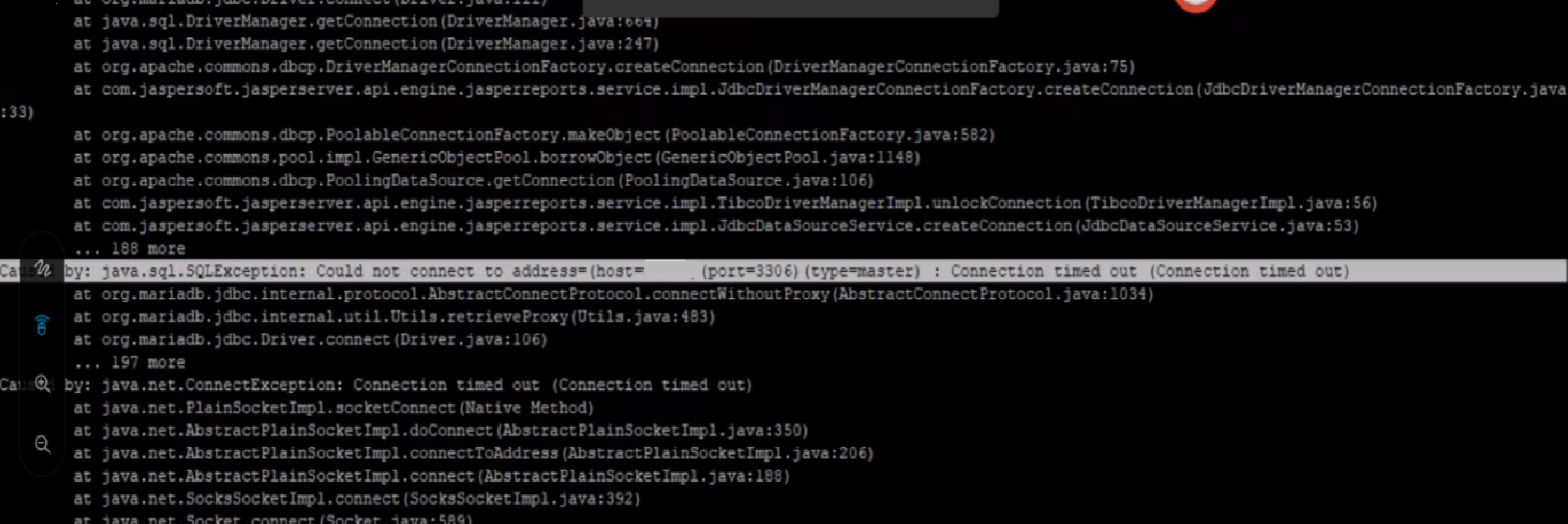

Unable to see the reports on cabi
Jasperserver.log shows below error
java.sql.SQLException: Could not connect to address=(host=OneClickSrvr)(port3306)(type=master) : Connection timed out (Connection timed out)
Release : All Supported Versions
Component : Jaspersoft for CA Spectrum
Unable to communicate with mysql on port 3306 because of firewall blocking the port
As per the jasperserver.log 3306 has a connection timed out error
