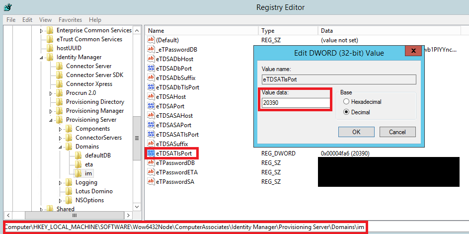

Domains/im/eTDSAPort and eTDSATlsPort registry entries have wrong values
Domains/im/eTDSAPort and eTDSATlsPort registry entries should have 20389 and 20390 values respectively. Mistakenly entered port values during past pwdmgr execution may have overwritten the correct values. To resolve this problem we need to correct the registry values.
Provisioning Server is running on Windows:
Run regedit, backup/export all registry entries under following registry branch
HKEY_LOCAL_MACHINE\SOFTWARE\Wow6432Node\ComputerAssociates\Identity Manager\Provisioning Server\Domains\im
and modify the following registry entries to have 20389 and 20390 decimal values respectively
HKEY_LOCAL_MACHINE\SOFTWARE\Wow6432Node\ComputerAssociates\Identity Manager\Provisioning Server\Domains\im\eTDSAPort
HKEY_LOCAL_MACHINE\SOFTWARE\Wow6432Node\ComputerAssociates\Identity Manager\Provisioning Server\Domains\im\eTDSATlsPort
