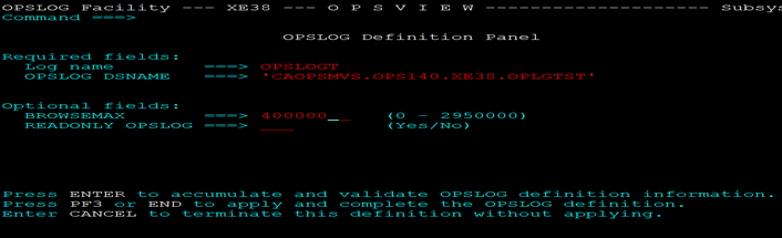

On the command line, enter "new":
On the screen that follows, choose the new log name to be displayed, the OPSLOG dataset name and the desired value for BROWSEMAX to match that specified in the OPSSPAxx member:
