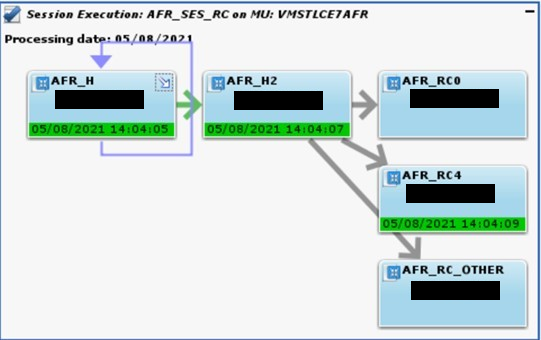

The most simple solution for this request would be a a RC session with 3 branches RC:
  • For rc=0
  • For rc=4
  • For every rc different than 0 or 4 which would be [-32767,-1];[1,3];[5,32768]
In the uproc AFR_H2 that can throw the custom return code (0, 4 or anything else) we enabled the Enhanced Status Management and added as Completed the Return Codes 0 and 4 as below:
This way when the AFR_2 uproc exits with return code 4, it will also be displayed as Completed (Green) and only the uproc AFR_RC4 will be launched:
