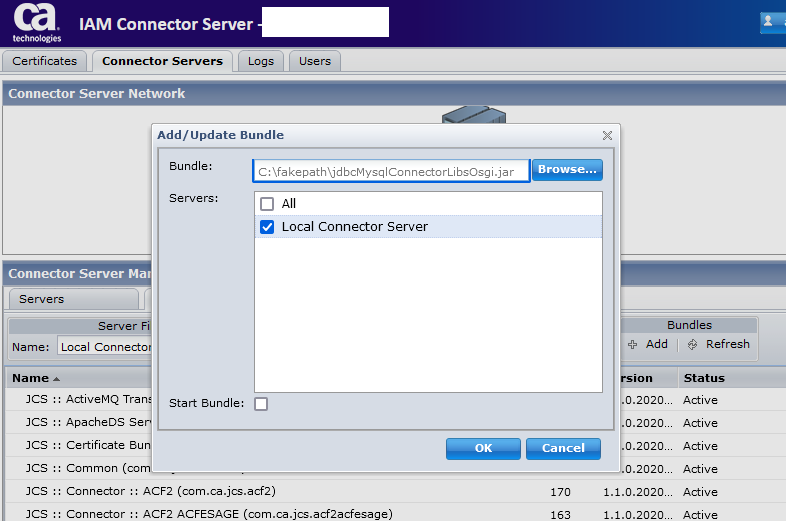

10) Add a new bundle:
      - Select 'Bundles' tab
      - 'Bundles / + Add'
      - Browse to the location and select jdbcMysqlConnectorLibsOsgi.jar file
      - Select 'Local Connector Server' > 'OK':
      - New bundle 'JCS :: JDBC :: MySQL JDBC Driver v5.0.8' will appear, search for it and select it
      - Right click and invoke 'Refresh Imports' from popup menu.
        New bundle status will change from 'Installed' to 'Fragment (com.ca.jcs.jdbc)'
