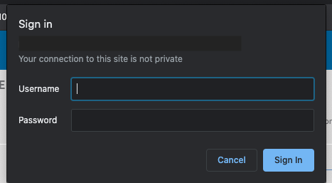

When attempting to access Insight in AAI you keep being prompted for username and password in a pop up box

When attempting to access Insight in AAI, you keep getting prompted for username and password in a pop up box.
