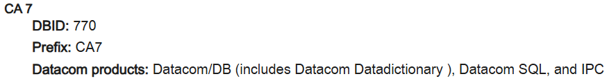

  2. Compare the Database IDs and their Occurrence names that you found on the report with the ones listed on the Products that Use CA Datacom/AD section of Datacom/AD documentation.
For example, a database with Base (i.e. DBID) 770 and OCCURRENCE CA7770 is found on the CXX report:
On the Datacom/AD documentation page you can read:
So this means that on the MUF region where you ran the CXX report, a database for the product "CA 7" is defined.
