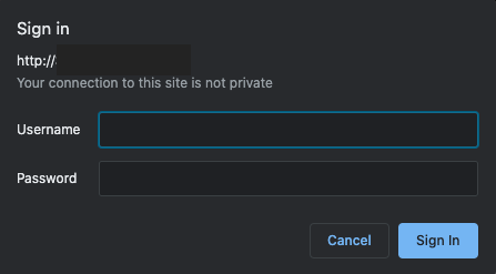

Unable to access Insight report data, and when accessing the AAI website you get a pop up window asking for credential to the Insight URL.
