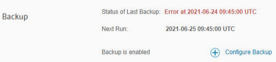

Our EDR backups failed due to insufficient disk space, which displays the following error.  How can we estimate the space required for the backup destination server?
Sample Error:
Backup error message "Status of Last Backup" reports "Error at 2021-XX-XX XX:XX:00 UTC"
Any EDR version where backups are supported.
