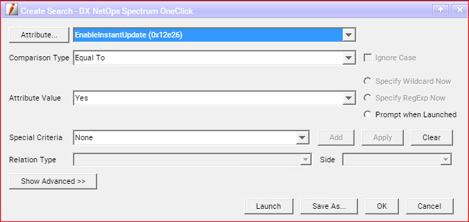

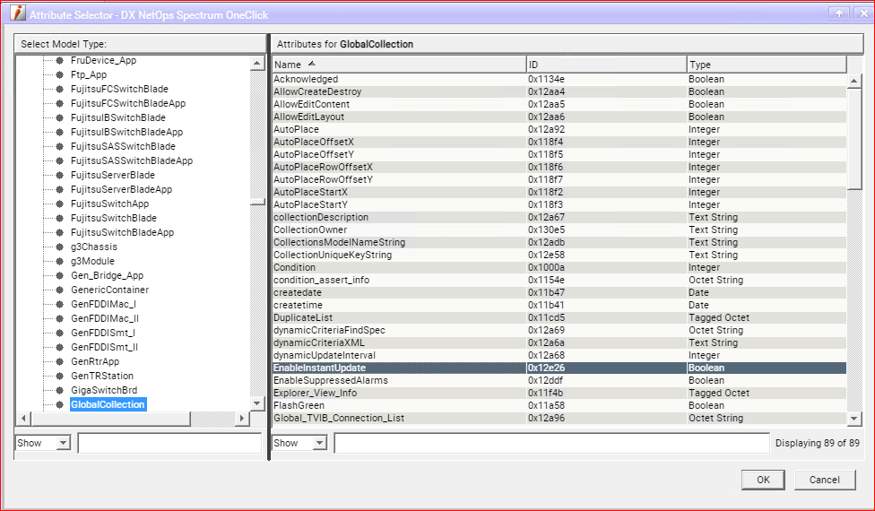

Which GC's are using Real-Time Update?
  • You can find all GC's set to use Real-Time Update with the Locater Search -> Create a New Search configuration shown here.
  • The EnableInstantUpdate attribute (Attribute ID 0x12e26) will be part of the GlobalCollection ModelType selection options.

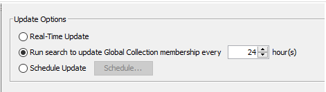

NOTE: One thing that is not well known is when you create a GC and set to run the search every xx hours, say 24 hours for example, the search is run when you click the OK button and the clock starts ticking at that time to run every 24 hours from the time you click the OK button.
So if you create or update multiple GC's around the same time, you can get multiple GC updates at approximately the same time.
To avoid this you can schedule GC's to run at specific times.
