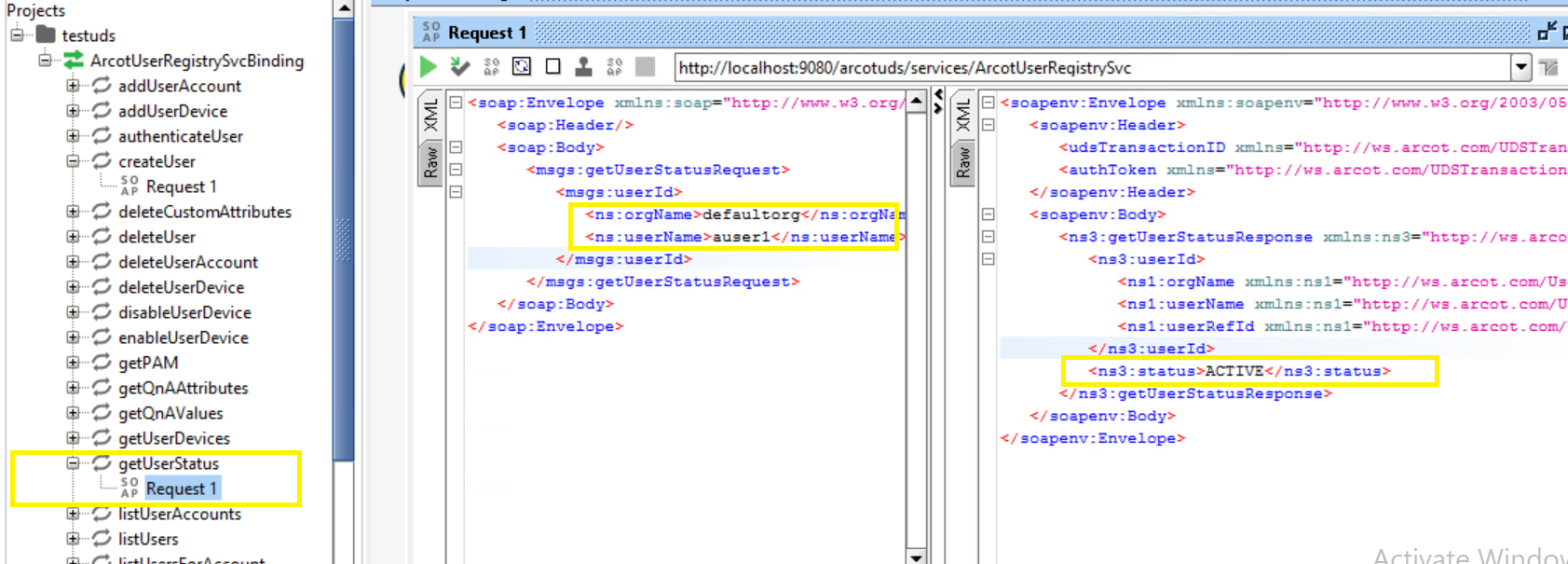

As 500 is a generic return code this section just exhibits a successful (return code 200) and unsuccessful  (return code 500 when the given endpoint is not reachable or in this case incorrect) webservice request - getUserStatus to UDS via SOAPUI.
1. Successful Webservices Request.
Successful  POST completed Webservices Request  (200 in localhostaccess log)
127.0.0.1 - - [26/Jun/2021:22:59:28 -0700] "POST /arcotuds/services/ArcotUserRegistrySvc HTTP/1.1" 200 808
2.  Unsuccessful Webservices Request /arcotuds/services/ArcotUserRegistrySvc1 used to create a non-existent endpoint leading to a 500 error in localhostaccess log. Essentially if the request cannot be posted to the endpoint or incorrect endpoint can lead to the 500 error.
Unsuccessful Webservices request to UDS leading to 500 error as shown in the localhostaccess.log
127.0.0.1 - - [26/Jun/2021:23:59:32 -0700] "POST /arcotuds/services/ArcotUserRegistrySvc HTTP/1.1" 500 661
