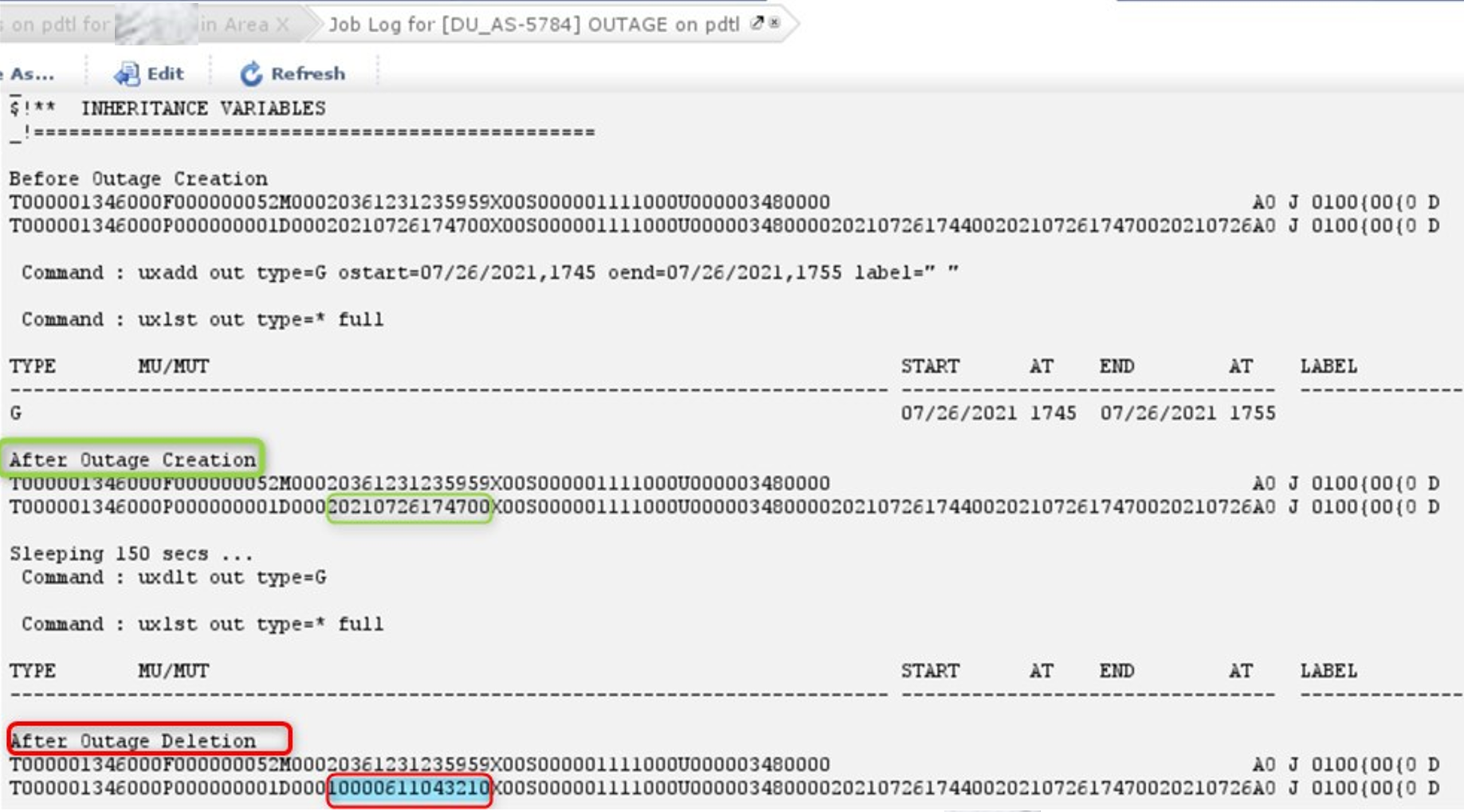

  • The calculator Wake Up date appears with a wrong date in the year 1000! In this example 11/06/1000 04:32:10
  • One of the uprocs of the affected Task ends in Time Overrun with numproc 0000000 and no History Trace with End Date the very same End Date in the year 1000:
  • If we look into the file u_fmta60.dta of the node and look for that same Date 11/06/1000 which translates into 10000611 we can see that it occurs after having Deleted the Outage and with the TaskID T000001346 we can retrieve the name of the impacted Task

  • When opening the u_fmta60.dta file with a text editor, we can see the issue in some lines in column 28 to 42, no valid date format is written, instead some funny weird characters are shown:

Bug: the removal of an Outage may provoke a wrong next Calculation Date to be set into the u_fmta60.dta (columns 28 to 42) for some Tasks where some uprocs inside the session were shifted by the Outage removal.

1. Identify the task/tasks affected by this issue by looking at the u_fmta60.dta file columns 28 to 42, if a funny value like 1000* is stored or some weird characters are in this position, you would need to disable this task.
