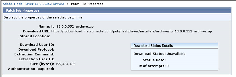

1. First, use the download URL listed in the patch to ensure the patch is actually downloading correct and is functional. If so we can proceed.
Click on Patch > Select Files > Click on the File that is giving you the checksum issue> select Download URL and try to download the patch.
