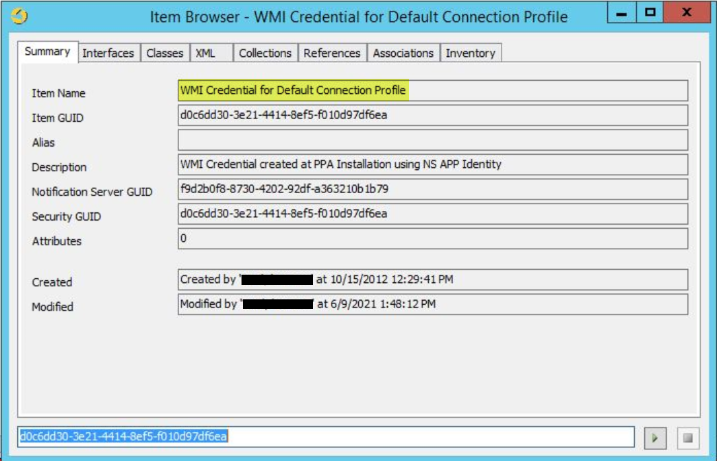

In the bottom panel of the Altiris log viewer, more information is displayed about the error highlighted in grey above as seen here:
Double-click the GUID highlighted in yellow above and you will see the following Item Browser information:
We see that the GUID refers to the "WMI Credential for Default Connection Profile".

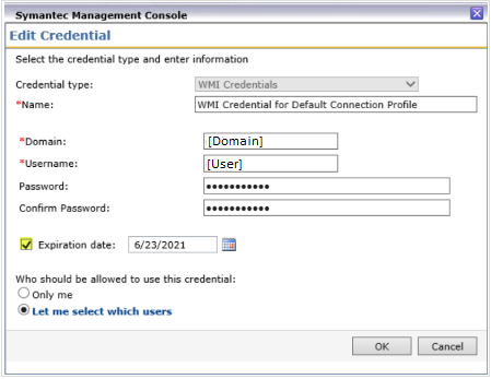

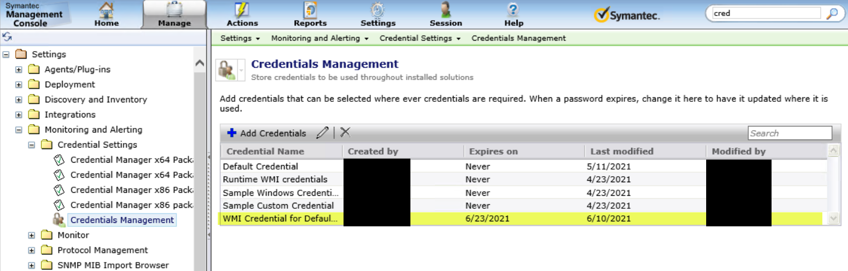

The Expiration Date for the "WMI Credential for Default Connection Profile" had been accidentally enabled as shown here:
