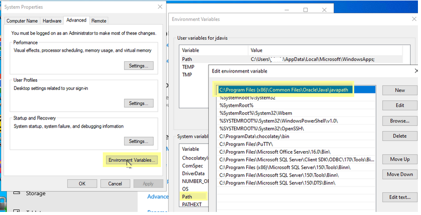

Note: If the JavaLocation is "", then SPE uses the environment variable for the Java install location
    • Windows: Java_Home
    • Linux: Path
