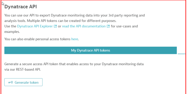

A Dynatrace API is required when integrating with BlazeMeter.  To create the API v1 login to Dynatrace and navigate to the following location:
Settings / Integration / Dynatrace API
Click on the button “Generate Token”
Enter a name for the token and select the entire scope for API v1, then click Generate:
Make a copy of the token and save this for later use:

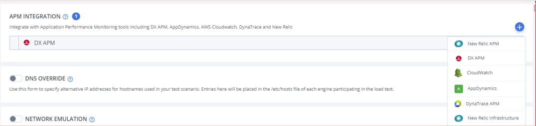

To include the Dynatrace metrics in a performance test navigate to the APM Integration section of the test and select “Dynatrace APM” from the using the blue plus sign button:
Select the Dynatrace credentials that were previously created and click Next:
