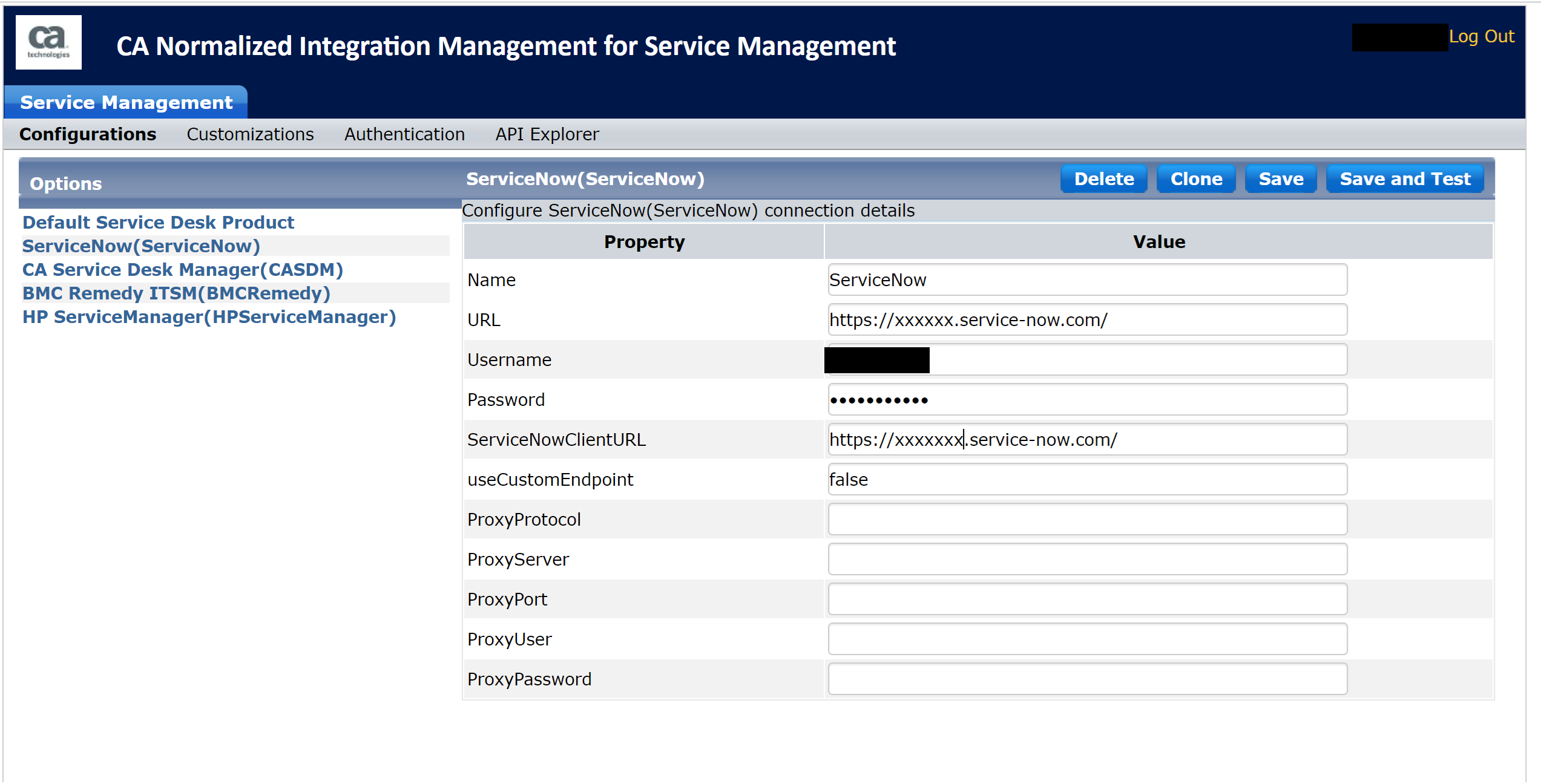

Also, from what you read, there will be some configuration on the NIM SM server? You found the below table that appears to be required information, some of which may need to be provided by the ServiceNow administrators?
ServiceNow
Property
Description
Default Value
URL
Specifies the URL to connect to ServiceNow.
Example: https://###.service-now.com
Username
Specifies the Username to connect to ServiceNow.
Example: johndoe
Password
Specifies the Password to connect to ServiceNow.
ServiceNowClientURL
Specifies the ServiceNowClientURL that is used to connect to ServiceNow.
Default: https://servicenow_client_host_name
ProxyProtocol
Specifies the ProxyProtocol to connect to ServiceNow SOAP Web Services.
Example: http
ProxyServer
Specifies the ProxyServer to connect to ServiceNow.
Example: proxy.###.com
ProxyPort
Specifies the ProxyPort to connect to ServiceNow.
Example: 80
ProxyUser
Specifies the ProxyUser to connect to ServiceNow.
ProxyPassword
Specifies the ProxyPassword to connect to ServiceNow.
useCustomEndpoint
Set the value of useCustomEndpoint to true when NIM has to communicate with ServiceNow through Custom Endpoint.
Section: NIM Configuration for ServiceNow Custom Endpoints explains more about NIM integration with ServiceNow through Custom Endpoint (or Scripted Web Service)
OPS/MVS
NIM SM can be deployed to an already existing current web server, if one exists.  Otherwise, the requirement is to setup and configure a new Common Services Apache Tomcat. This web server can run on any platform, and does not have to be on the mainframe.
The following areas of documentation are specific to the above questions:
As far as security, your setup must be able to accept REST requests.  A USERID that has the authority to create ServiceNow tickets is also required.  A username and password should be enough.
Once NIM-SM is deployed and started, the Service Now administrators will need to provide the information needed to populate the ServiceNow Option under NIM-SM as follows:
