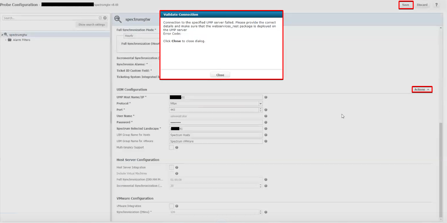

When configuring the spectrumgtw probe, we are getting failures when validating the connection to OC, or same error when trying to Save the configuration.  We have the webservices_rest package deployed to the UMP/OC server. Our validation to the Spectrum environment is successful.
  • Customer can successfully validate the Spectrum configuration via Actions->Validate->connection, but cannot Validate the UIM (OC) connection (where the Operator Console machine is located).
  • Customer also cannot Save the spectrumgtw configuration in the Admin Console.
Popup error:
Validate Connection
“Connection to the specified UMP server failed. Please provide the correct details and make sure that the webservices_rest package is deployed in the UMP Server”

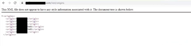

Then hit the url:
   http://<IPAddress_of_OC>/rest/origins
and login using your UIM/Nimsoft administrator account and password.

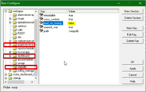

***This error is normally due to leftover artifacts from previously installed versions of wasp webapps***
You can choose to follow the process to completely remove the old wasp webapp packages or you can set load_on_startup to false.
Listed below are some of the wasp webapps that were old/leftover artifacts, which were interfering with the connection validation and Save operations in the Admin Console.
To work around the issue right away, we edited the wasp.cfg and set load_on_startup to false for the webapps listed below:
  • jasperserver-pro
  • dashboard
  • umpjslib
For example, via Raw Configure:
In one other related case, the old dapi webapp also had to be disabled/removed.
After making the changes to wasp,
  1. Deactivate wasp, wait until the port and PID disappear then
  2. Activate wasp
  3. Run the /rest/origins call once again to see if it yields successful output and no errors – example below.
  1. Now you should be able to revalidate the connection via the Admin Console and/or Save the spectrumgtw configuration without any further issues.
