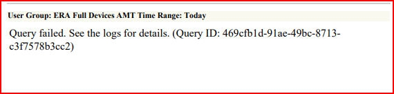

The Dashboard has just two Views on it, and the failure is random which one is impacted.
Views on the Dashboard in the PDF show a message like this. The Query ID will be unique for each instance of the error.
